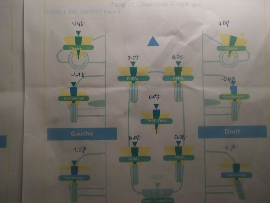

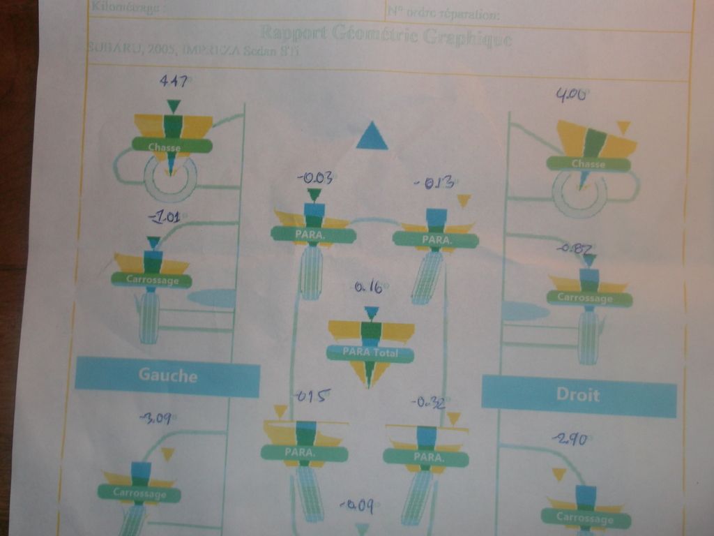

Can you post the alignment sheet?

Here is a picture of the alignment sheet.I filled the numbers in,couldn't really see them.
Before:
After:
Now the rear right is within spec.

No offense but whoever "aligned" should maybe retake the course. There is almost a .7 degree difference between the left and right camber in the rear, .5 in front and wow that rear toe... RR has a good amount of toe out. Better than what it was but not perfect, RL is slightly toe in and same with FL
I love how the write the numbers by hand on the report sheet!!!
