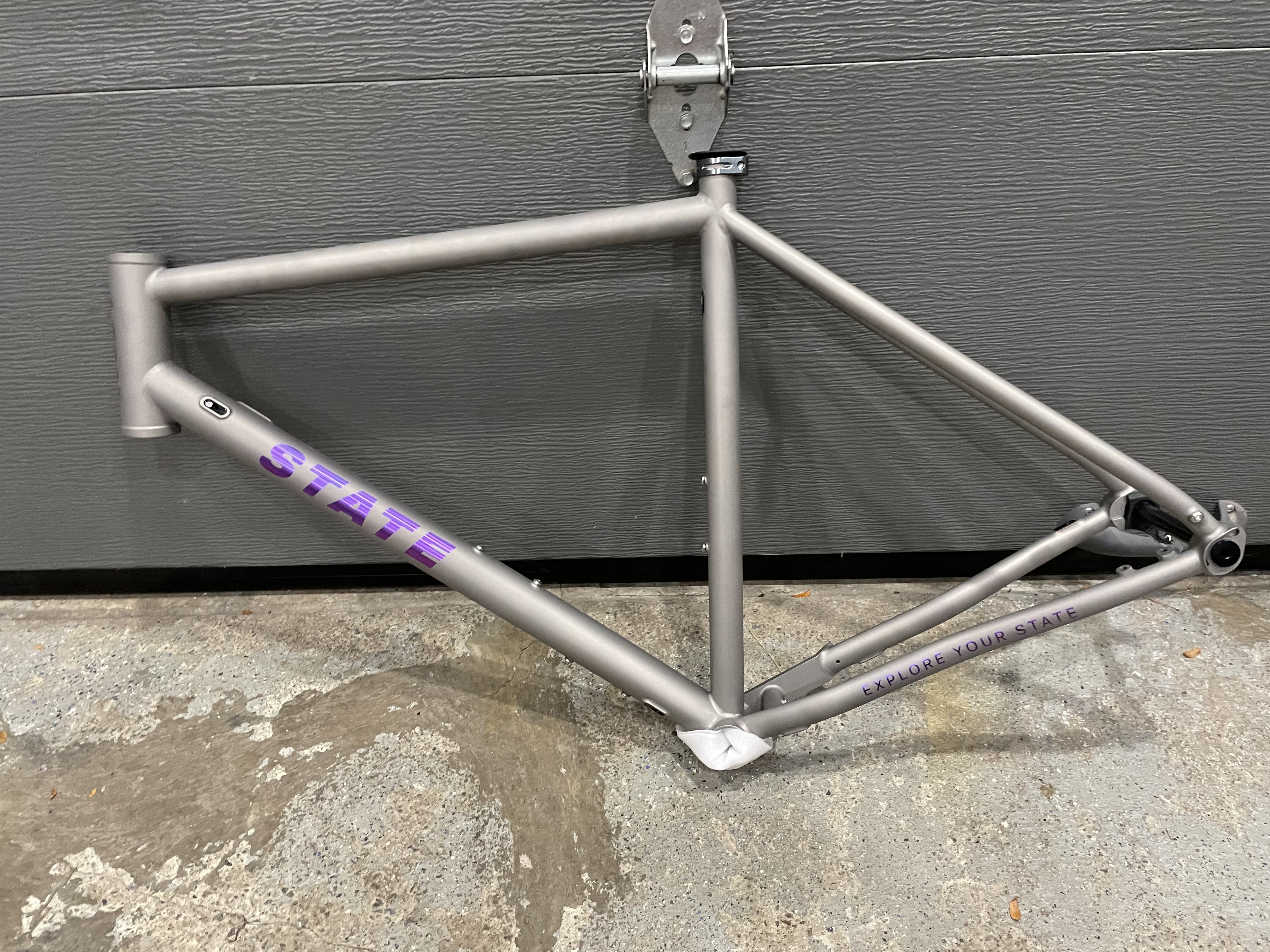

New bike day. ca va être mon nouveau commuter pour aller travailler quand y fait pas beau.
State allroad titanium. Comme j'ai déjà un litespeed monté "route", celui là va avoir un guidon droit. Mixt GRX810/Deore/XT.
J'ai acheté des roues Hunt 4 season pour l'hiver, sinon Ksyrium pro pour l'été. Bien hâte de monter ça.

New build for my work commuter. I will use this in winter (snow) and summer.
I wanted 11speed to share the wheels with my other bike; so the only XT that was compatible with I-spec EV mounting is M8130 shifter and rear derailleur.
XT8130/8100 build, with GRX810 front derailleur and caliper. Full liner housing and Jag wire elite sealed shift kit. Crank is a QUARQ with 36/46 rings.
I added full fender set for "fun" weather. This frame can fit 50mm 700 tire and a massive 2.2 650b tires!
winter wheels are Hunt 4 seasons with schwalbee marathon winter, summer wheels are mavic ksyrium S on G1 allaround.
only thing bad, the frame has 2 cable entrees on the right side of the frame and one on the left side. Still figuring out the best cable routing. Right now, front shifter goes on the frame right with the rear derailleur (awkward bend, I know), and the frame left side has rear brake.
