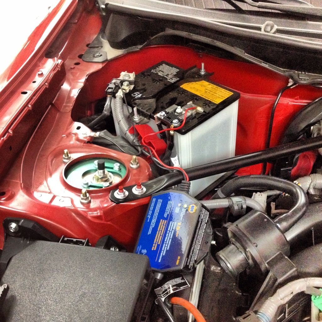

Are you guys using any slow chargers on your summer cars or bike.. i bought two napa 1.5 amps chargers for my FRS and my Ninja... i ve never done it in the past and killed some batteries, hopefully this time i can spare that... i installed the first one on the bike and right away it said that it was charged, but i do start it about once a month for a good 20-30 minutes but the FRS has been grounded since october and that one seems to be charging right now, hopefully it wasnt too late, it was disconnected since then also.. what are you guys using

By the way; SilverDub... In your picture, it doesn't look like the negative is connected in the right spot. It's not on the main grounding cable???
