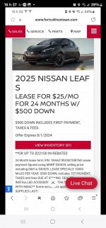

Get a used EV6 or similar. Buying a Leaf would be equal to buying an Iphone 6. I dont think you understand how outdated a Leaf is.
Whats annoying is even with all the incentives in QC there are still no good lease deals like the USA.
We get so screwed with lack of EV offerings. Im in Ireland now and its full of MG4 and BYD Atto 3
They wanted new, it's done anyways. I drove it tonight and it's the equivalent of a beige corolla, nothing wrong but nothing great.
Im in Dublin right now. BYD Atto 3 are everywhere along with MG4 and MG5. EV marketplace in USA/Canada is horrible, here is a lacklustre overpriced GM product!
Lol dit à tes parents d'aller chercher ça au Colorado à place :D a 25$/month j'en commande 3
