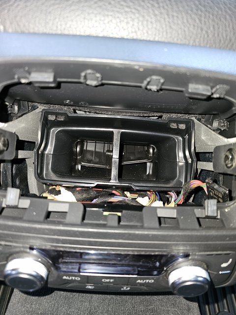

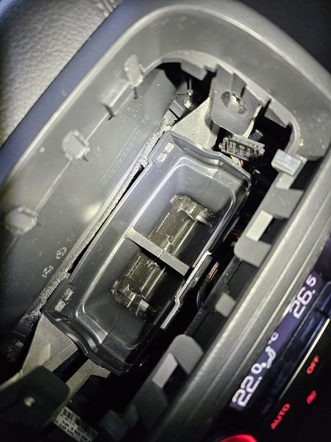

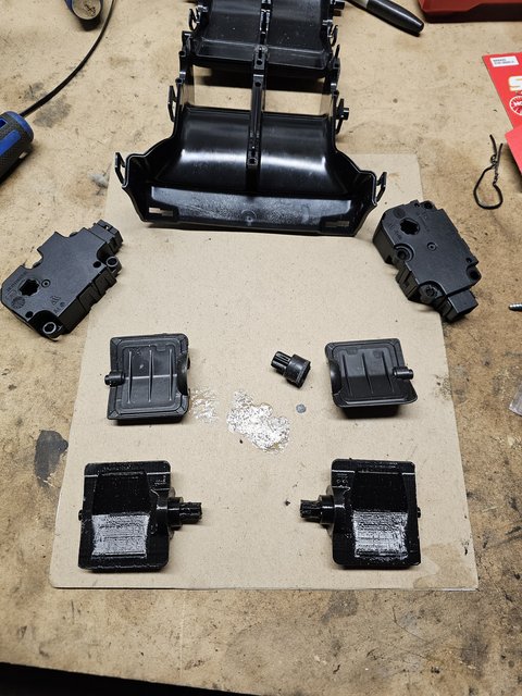

Finally got to fixing the rear HVAC flaps on my A6...been getting an electronic/gear noise coming from the back for a while now...after doing and autoscan and searching online I found out this is a pretty common fault on the C7 platform(especially in colder climates where heat is used).
Basically the blende flaps for the rear climate control fail/melt and the motors spin non-stop looking for their home position. Thankfully i found someone who already designed new upgraded flaps that you can 3D print...took about 30mins to do the whole thing
